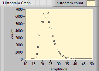

I also played with this.  The problem is that the Histogram Graph, for some reason, is not producing Bar Plots (I think this is a bug).  It also needs to have the Y axis set to AutoScale.  Here's your Histogram where I've set Y to AutoScale and have changed the Plot Type to Points (right-click the pale area just to the right of the words "histogram count", choose Common Plots, and choose another Style).

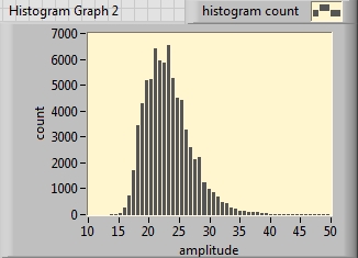

I figured it out!  Here is the Histogram you want, looking just fine ...
So I looked at the data, then looked at how the data were being processed.  I never did like the Spreadsheet functions, so I wrote my own "Break this huge string up into an array of strings (there are over 75,000 of them in there!), use Scan from String to make them Dbls, then simply pass that to the Histogram function, specifying 50 bins.  The result (above) speaks for itself.

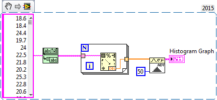

Here's my code.  The only thing I used for the original post was the giant string.  I actually coded my own "parse lines to array" using pattern matching, but the OpenG function is much faster.  The Histogram Graph was created by right-clicking the output of the Histogram function and saying "Create Indicator" -- What You See Is What I Got (Wysiwig, alternate spelling).
