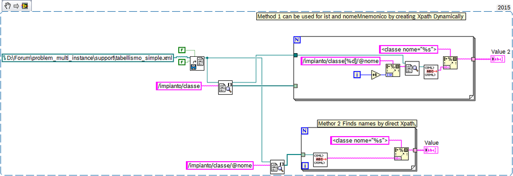

Try like the same for ist and nomeMnemonico

Xpath For nomeMnemonico     "/impianto/classe/istanza/@nomeMnemonico"
Xpath For ist    "/impianto/classe/istanza/@ist"
which will give all Values irrespective of Classe Name so make Loops in such a way Classe values are extracted.

You need to use your xpath in such a way you expect the output.
