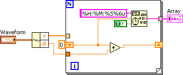

Yes, you can do this as well. I normally just use the Write to Spreadsheet File but you can modify the Export Waveforms by doing somethinkg like is shown below. Instead of the functions Get Waveform Time Array and Waveform Time to Date Time String, this code will generate a series of relative times starting at 00:00:00. Note that this works on 8.5 and there may be some slight differences in the creation of the time string with your version. I don't have 8.2 so I can't test it. Also, since you are changing the functionality of the Export Waveform function, be sure to save it with a new name and in a new location.
