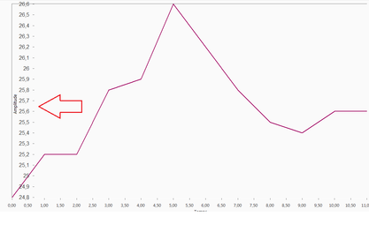

problem with Graph multi-scale.

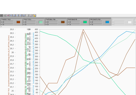

I how can solve this problem automatically, When the Y axis shifts,Knowing that I also use a method to plot a multi-scale Y graph.
My multi scale in graph works at first time but after some test He does that to me.

You may want to try...
On the Front Panel right-click the graph and choose
Advanced >>> Auto Adjust Scales
to deselect that option.
Ben
