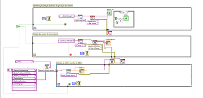

I'm developing a LabVIEW program to collect CAN network and temperature data.
I programmed it to run stand-alone with the cDAQ 9135. It works, but after about 10 minutes it crashes.
I tested it both in stand-alone mode and connected to a PC — in both cases, it crashed.
I'm using LabVIEW 2015 and its corresponding drivers.

  1. Move the Create DAQmx Virtual Channel VI out of the while loop.
  2. You don't have proper error handling. Please refer to the shipping examples at Help >> Find Examples >> Hardware Input and Output
