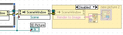

The reason is that the action in the "Scene Window" case (Render to Image) takes a significant amount of time. On my not-so-new dualcore desktop, it takes about 230 ms per iteration...
If you replace your Picture indicator by a 3D Picture and directly connect the wire that you are currently connecting to your Scene property to it, this is pretty much instantaneous:
