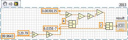

I can't open your VI as I'm tied to LV2011 here so I guess you missed the inversion dots at the last CompoundMath node…
the example you gave me is one way to go, but i am not an expert in math, so it was not that logical for me to do it in that manner, since i had the formula already it would be easyer for me to just use that.
I just wired your formula using basic LabVIEW functions…

hi
you are of corse correct, i managed to miss that. 🙂

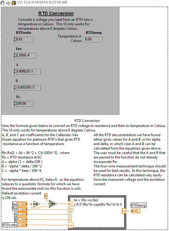

For those keeping score the code with corrected inversions at the last compound math node (Good guess Gerd!) is:
in a formula node it would look like thus
I still can't find a souce to support 3.9135e-3
