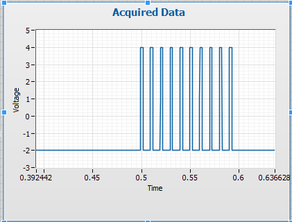

When I run you code, I get an AO waveform every 500ms as expected. I suspect your problem is that for each run of the AO task, you output~10 copies of your waveform.
Your AO code is set up for a finite output, and it's using the default "number of samples per channel" of 1000. Since your waveform is 101 points long, DAQmx generates coppies until it gets to 1000 samples. If you do only want to output 101 samples for ever trigger you get, set the DAQmx Timing  vi to 101 samples per channel.

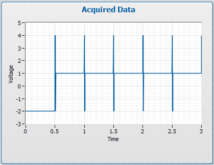

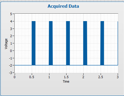

When I set that, I get a single high then low cycle every 500ms.

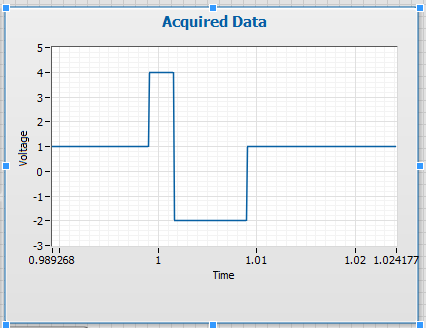

(1) There is still the behavior of the while loop that doesn't seem right: It still appears to 'free-run' with ~50 ms duration per iteration, instead of (per my expectation, at least) cycling at the same rate as the trigger edges (500 ms, or whatever I put for that value).  Isn't the 'DAQmx Wait Until Done' function a blocking function that should wait each iteration until the finite AO pulses are triggered and completed?  And thus shouldn't the while loop iterate at that same (slower) interval?
(2) Perhaps related to #1 above, when I watch the AO outputs for a while, it appears that they eventually become "corrupt" --- either they stop triggering, or only part of the pulse gets output (thereby holding the channel at the incorrect voltage), etc.  The CO output on Ctr0 remains consistent, so it's not because of the loss of the trigger itself.

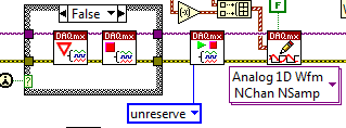

The easiest workaround is to manually un-reserve the task between stopping and writing using the DAQmx Control Task vi. This will add as much as 30 or 40 ms of extra overhead but as it is now, you are only writing for 10.1 out of 500ms, so an additional 40ms of overhead won't cause missed triggers. Un-reserving the task effectively clears the hardware, resetting that interrupt.
Once I add the unreserve, I get nice consistent 500ms loop times.
