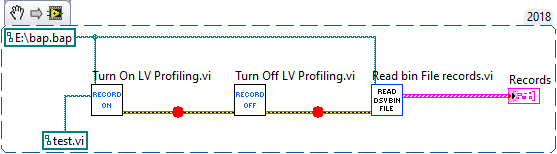

This gives me results.
But it's tricky! It only gives results for (sub) VIs that executed. Also execution of those VIs is somehow blocked by the profiler. My test.vi (that should be a path of course) didn't execute until I continued from that 1st brakepoint. It's probably designed to run in another context...
The results are somewhat cryptic as well. But that's what you get once you go low level...
Message 7 of 8
(4,827 Views)
I think this works mostly as expected, and does everything asked for?
Except "Also, how can I save the results into a spreadsheet?". I hope that's clear now we can get data? It's really a completely different topic.
