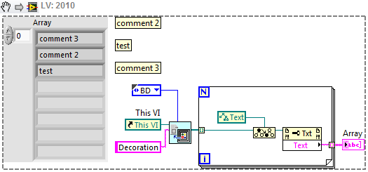

Like this:
Note that this will actually return all the decorations on the BD, so you might need to check the error out on the TMSC node. Alternatively, you could just ask the traverse VI to look for the Text class, which is probably better. I'm also assuming that in your case you will want to use a reference to another VI.

That's exactly what I'm looking for. Where do I find the subvi that returns the references to the block diagram decorations?
(3,573 Views)
As you can see if you drag the snippet into a BD, the VI is found in vi.lib, but you can also display it in the Application Control palette if you enable scripting in the VI Server page of the options dialog.

Perfect. Thank you.
