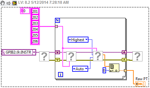

I tried using array as you showed, but i fail to get it to work properly, well it works as it should but i want it to be able to stop with a button, when i did that only channels 202 - 206 stopped. 201 kept going.
The reason for me to have this opportunity is that later i will connect channels 207-212. and they also will need to be started/stopped seperatly. - Solved with a case structure inside the for loop
Also, frome here on out, how would i go ahead and use the data? Can i in a "state machine" use several for loops to perform the same tasks as i had in my previous version?
I am not afraid to ask stupis questions, so here goes...How did you get the Raw PT "DBL". (bottom right corner).
I appreciate your input

Hi Torb,
that button belongs into the loop - THINK DATAFLOW!
When you want to "break" channel 201 too you need to add an additional case structure...
Put the stop button inside of the loop.  The button is read with the terminal.  The terminal is read outside of the loop, so it will have the same value for every iteration of your loop.  By moving the terminal inside of the loop, your terminal will be read every iteration and you can therefore abort the loop.
A state machine is actually just a single loop.  You can use a state macine with other loops, you just need to be careful of how you pass the data around.

does this make sense?
I got it working putting a case structure inside the for loop for evry "batch".
It works as i want it to work, but is it a good way of doing it?

I cant look at the code right now, but from your description i'll ask: Can it be made to a sub-vi so you'll only need to change it once? Can you loop through batches instead of having several?
