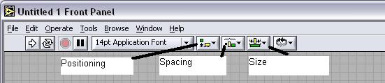

I'm a little confused by your description. Are you moving the plot areas around during run-time? Otherwise, why would you explicitly set the plot area size and position during run-time, rather than using edit-mode alignment operations shown below:
Also, auto-scaling on your graph shouldn't change its size or position. It might help if you posted a VI that demonstrated some of your concerns.
