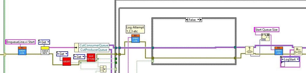

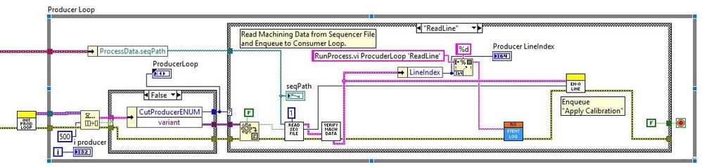

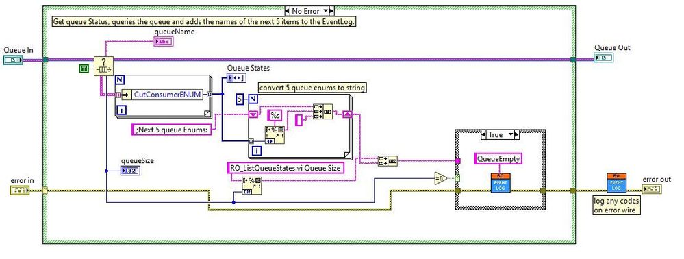

Thanks for the suggestions.  Here a snip of code to be clear how simple it is.
The Producer Loop:
Inside the Enqueue VI:
The queue reference comes from the yellow colored Functional Global Variable VI.  At 200,000 lines per day between 9 manufacturing rigs, that's 73 million enqueues a year.  We're seeing the fail around 6 times per year.
So far, it has only failed at LineIndex greater than 1000.  The largest features machined are around 6000 lines.
You will notice I have put a case structure and a while loop in there.  This is a recent attempt at reversion, if the error occurs, the VI will clear the error, re-read the Reference and re-attempt the Enqueue.
