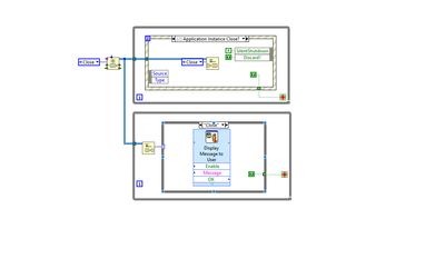

Hey, am I doing this wrong?  I wrote up a little Test VI because this doesn't seem to work the way I remember doing it in the past. (Although I don't remember that "Silent Shutdown" being an option).
Press the top right X - set Discard to True - and continue as normal (And more specifically - controlled) shutdown procedure.  LabVIEW 2020SP1

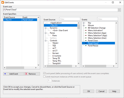

I've never used application instance close, rather <This VI> Panel Close?
(2,641 Views)
I'm guessing that, since you didn't handle (and discard) the Panel Close? event, that the panel still closes. Closing the panel will kill the whole program immediately, and the Event Structure won't be able to handle anything.
And I agree with Antoniooh- I think you should be using Panel Close, not Application Instance Close.
The Help is a little confusing: https://www.ni.com/docs/en-US/bundle/labview/page/lvprop/app_app_exitq.html
When not running in a Project, the Application Instance Close event fires when you use File -> Exit. If you use File -> Close then it triggers the Panel Close event.
If you want to handle clicking "X" at the top right, use Panel Close. If you want to handle File -> Exit, use Application Instance Close.
