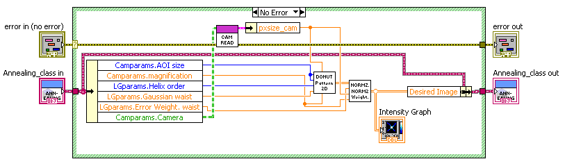

I am wondering about the case where some variables are unbundled out of the cluster of private data, operations are performed, and some other variables are bundled into the same cluster, as in the following illustration.
My question is: in such a case, is it worth it using In Place Element Structures for unbundling and bundling instead of simple "Bundle/Unbundle by name" operations ? In the case illustrated in the picture, is there a risk of burdening the memory (or at least the CPU) with the entire private data of the class at some point ?

When you expect that the data type and size is not going to be affected, I would use the In Place Element Structure. So mainly for changes of the content.
For rather small operations it's often not worth the trouble of setting it all up.
Anyway, for large data operations I have noticed an better handling of memory, but this isn't scientifically proven / shown in nice figures. For speed, I can't say anything.

The note is a mantenance tip while the question you are posing is performance related.
The "inplace-structure" is not a magic bullet. It only helps you communicate your intentions ot the compiler. Most of the inplace opeartions can be invoked simply by structuring out code such that LV can optimize the data buffers.
The code you posted would have to be reworked a bit to actually be effective using inplace operations.
I believe the "Annealing_Class" data will be handled inplace but the buffer for "Desired Image" seems to be a candidate for inplaceness IF it does not grow inside the donut or as a result of normalizing. The update of the intensity plot will demand a buffer copy of course.

Since the "Desired Image" array has a fixed size, it is then a good candidate for an In Place structure..
A quick question: how did you determine that the first Unbundle operation was likely to be handled in place, unlike the Bundle operation that follows it ?

Years in the dark running benchmarks for threads like this one (this may be a good thread to learn for yourself).
How can YOU tell?
Get used to running benchmarks using large data sets (large enough to be measured) and get into the habit of using Profile >>> Show Buffer Allocations.
For your code then you should break-out the image data pass it THROUGH the sub-VI and put it back in the private data.
The "Clear as Mud" thread will tell you how to make sure you are passing the data through and not a copy.
