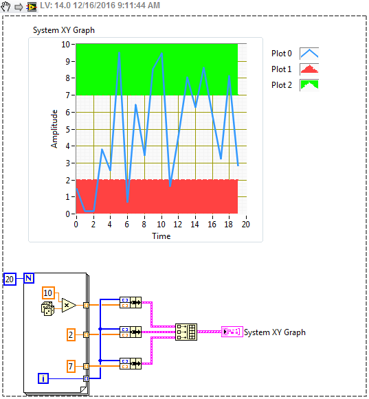

Hi A.,
use additional plots in the graph, one for upper, one for lower limit.
Change their properties to the desired fill behaviour…

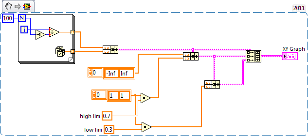

Yeah what GerdW said.  Here is an example.
(4,668 Views)
2 little things:
Limits can be 2 point arrays not to waste data
If their x ranges are infinite, graph x will not autoscale on them and they will cover full graph.

Great improvements, especially the scaling thing.  I didn't try zooming out, but if I would have, then I would have seen the limits are only the same X that I provided.  Your solution works much better for this.
