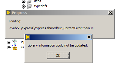

Hmm. Today I'm getting this exact same issue. I have just installed a number of toolkits however so I'm going to dig around and try to get to the bottom of it...
Oddly, it shows problems loading Express stuff, and I'm not aware of any NI express code in my project...

OK.... Odd....
1. I made a backup of my entire project to work from, duplicating all VIs into a temporary location.
2. I closed LabVIEW, then opened the duplicate project. During load I saw the "Library information could not be updated" message.
3. I removed three VIs from my project relating to one particular driver (I don't think the exact VIs are relevant, but I had to start somewhere), saved the project, closed LabVIEW and reopened to project to see if the message would appear. It did not.
Ha! So "the issues is related to these particular VIs", I thought.
I closed LabVIEW completely and went back to my original Project, opened it and... no error message. But I haven't changed anything here, nor edited any VIs yet. Somehow my original project has stopped complaining!?!
What gives here? Cache bin flush?
