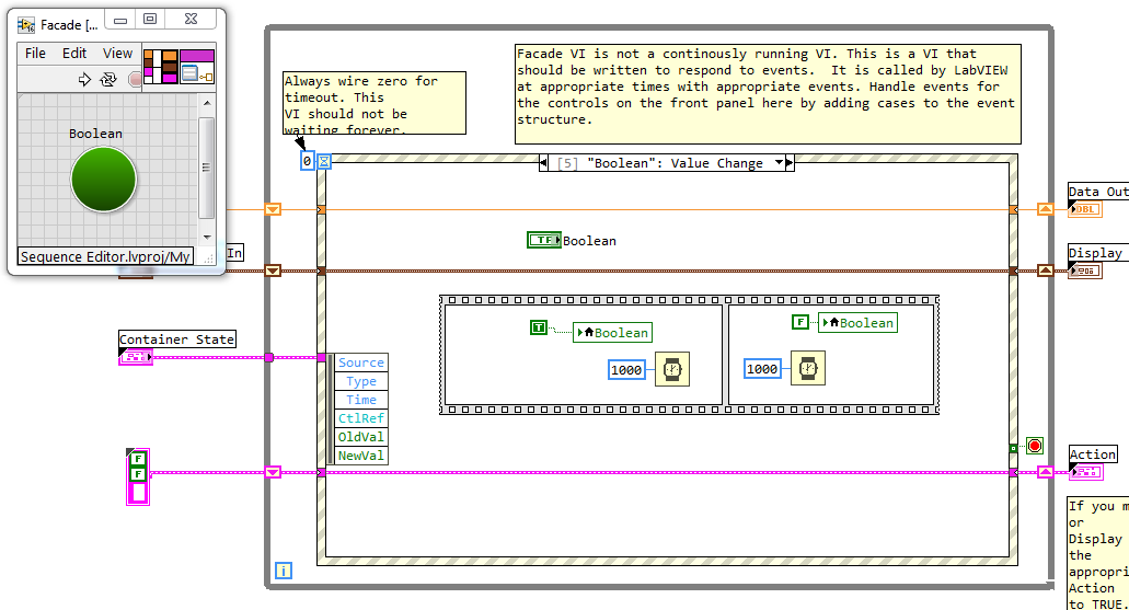

I'm trying to use "Limit maximum instances of a mouse wheel event in event queue" inside an XControl Facade VI. In most case, the "Limit maximum instances" option works just fine. But when I use it within a Facade, I noticed that when the event case is running, and more of the same events are generated, they will be enqueued after the case finishes one after another, rather than being enqueued and flushed while running.
To be more specific, consider the following VI. I have already checked "Limit maximum instances of this event in event queue" option and set the "Instance" to 1.
When I click the Boolean 5 times within 2 sec, I'm expecting this event case to run only twice. All events between the first and last should be enqueued and flushed.

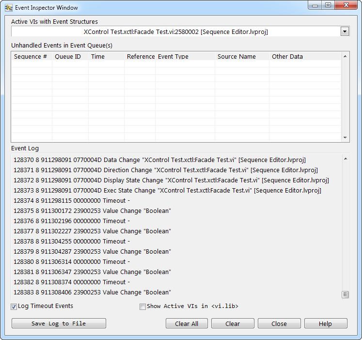

But what I got from Event Inspector Window is the following.
The Timeout event seems to prevent the Value Change event from enqueuing.

From experience the Limit maximum instances of this event in event queue has no effect in the Facade VI. LabVIEW seems to internally buffer the events and feeds them to the XControl regardless of this setting.
That said, you can limit the number of Data Change events which are received by the XControl. To do this, edit the .xctl file with a text editor and add in the bolded line below:
