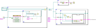

Here's my hacky script (was planning to clean up and eventually roll it into our CI process, so we could fail a pipeline if cyclic dependencies were introduced):
I was specifically excluding stuff from vi.lib (technically, everything in C:\Program Files (x86)), and building a map of the class dependencies of each class in my project directory. Then, iterating over the map elements to look for cross-linking.
When I noticed the inconsistent behavior, I added that Write Text File operation to dump the results as JSON to disk. Then I ran this utility once by itself and once after opening the main project file that contained the classes I was analyzing, and compared the resulting JSON files using a diff viewer. Sure enough, there were significant differences in the two files.
