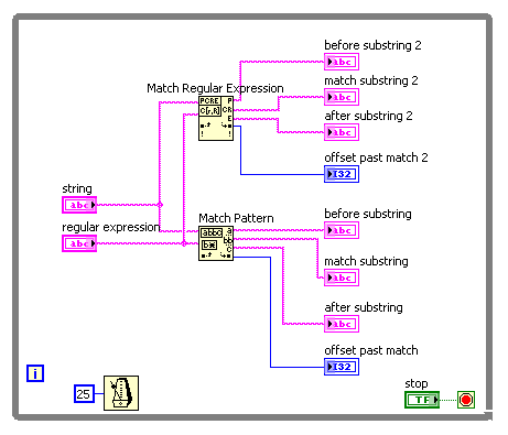

I have a simple string matching need and by experimenting found that the "Match Regular Expression" and "Match Pattern" vi's behave somewhat differently. I'd assume that the regular expression inputs on both would behave the same. A difference I've discovered is that the "|" character (the "vertical bar" character, commonly used as an "or" operator) is recognized as such in the Match Regular Expression vi, but not in the Match Pattern vi (where it is taken literally). Furthermore, I cannot find any documentation in Help (on-line or in LabVIEW) about the "|" character usage in regular expressions. Is this documented anywhere?
For example, suppose I want to match any of the following 4 words: "The" or "quick" or "brown" or "fox". The regular expression "The|quick|brown|fox" (without the quotes) works for the Match Regular Expression vi but not the Match Pattern vi. Below is a picture of the block diagram and the front panel results:

The Help says that the Match Regular Expression vi performs somewhat slower than the Match Pattern vi, so I started with the latter. But since it doesn't work for me, I'll use the former. But does anyone have any idea of the speed difference? I'd assume it is negligible in such a simple example.
