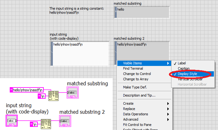

I have observed some unusual behavior with the "Search/Split String Function", and would love some help to learn why and/or how to work-around this issue.

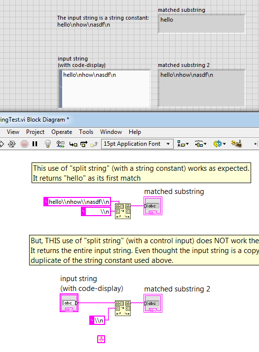

Behavior:
1. When the "Search/Split String Function" is given a 'newline' (\n) delimited string constant, it is able to correctly parse and return the first token before the newline delimiter.
2. However, when the "Search/Split String Function" is given the exact-same 'newline' delimited string through a 'string control' (i.e. a string input text field), it is incapable of finding any 'newline' delimiters.
I have attached a minimal example from Lab View 2018 patch 2 (18f2) that demonstrates the issue.
Question 1: Does anyone know what's going on? Is this a bug, or am I missing something obvious, like some function parameter or string-encoding?
Question 2 (which is less important): I would ultimately like to use the "Search/Split String Function" to split on a null character ('\0'). I know some other LabView string functions do NOT work with the null character. Does anyone know if this "Split String Function" works on null characters?
- Thanks!

No bugs, just a misunderstanding about the various string display modes and how each format represents your actual string characters.
For your constant, you added "\n" into a string that was in "Normal display mode".  That's really a "\\n".  You did the same thing for the "\n" you were searching for (really a "\\n").  So hear you have a match.
For your indicator you switched the control's display mode to "\ code display", and there you see the "\n" (LF).  Note there's no extra slash, so when you search for a "\\n" string it doesn't find one.  Everything works as it should, just not as you intended.
I suggest playing with the various string display modes a bit more, and also using the provided LabVIEW LF primitive.

Since you are using a relatively recent LabVIEW version, I strongly recommend to make the display style visible whenever it is not normal. This avoids a lot of mistakes.
(Also see this idea from 2009, now implemented :D)
