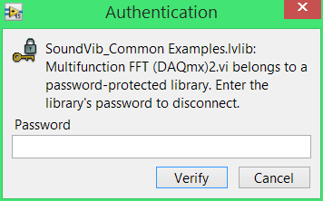

Please help !!
(8,094 Views)
If it's a National Instruments VI, then they've probably password protected it for a reason (e.g. because it's their IP). You probably shouldn't be trying to modify/remove these VIs from their libraries.
If it's a VI you've created, then you should know the password!
You could try to 'save as' on the VI, maybe it will save without being part of the library and the VI itself isn't password protected.
