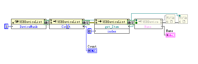

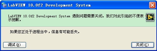

hi, cocopa,
I am trying to use CyUSB.dll in LabVIEW too, but failed.
My code as follow, it is good running before method "get_Item", and the count of USBDeviceList is 1 or 0 depends on CY7C68013A is attached or not. When it runs after  method "get_Item", LabVIEW will be crashed....
It's very kind of you if you give me some advice or an example.
