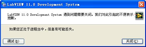

Hi, Michael,
Thank you for reply.
I have tried in English version of LabVIEW 2011, but there is also a same problem like before.
Because of my Windows OS is Chinese version, so the error message is still in Chinese.
Google translate it as bellow:
LabVIEW 11.0 Development System has encountered a problem need to close. We apologize for the inconvenience.
If you are in the process of which the information may be lost.
[Button]Debug                            [Button]Close

Hi Diller,
So to clarify, when you run that code in either LV 2010 (Chinese version) or LV 2011 (English Version), LabVIEW crashes and you get a Windows error message saying that "LabVIEW 11.0 Development System has encountered a problem need to close. We apologize for the inconvenience."
Is this correct?

Hi, Michael,
According to your words, the error message really comes from Windows, because the two are in Chinese.
