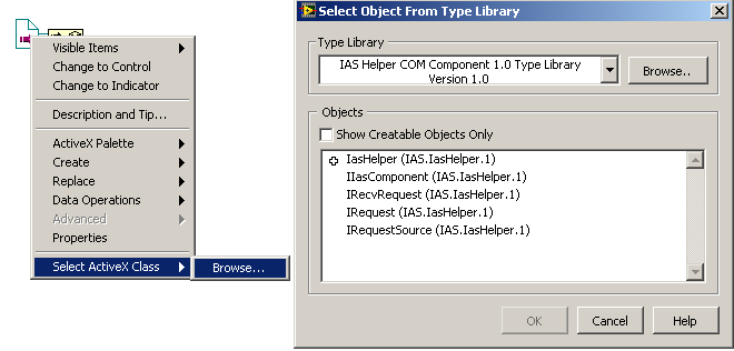

If your right click on the active-x class reference, choose Select Active-X Class, and browse; do you find the same original class that you had selected initially?  However, if you select the correct class, you should then be able to debug the rest of the Property Node.
