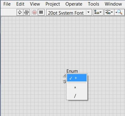

If I create an enum with the following items:
"+", "-", "/" and "*", I cannot see the item "-" on the front panel as an option.
Is it a restricted character to use in enum type? Before you say, I know I can just use a Ring type, but I just would like to learn why I see this behaviour?

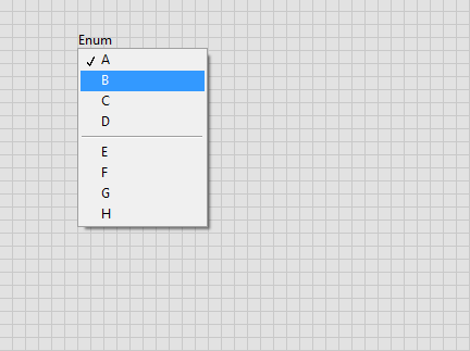

I don't think its restricted, probably a bug with Enum and Ring. Try to set the " - " as Last or first element of the Enum and select the "Line/divider" that appears when you pull the drop down, you can see the value " - " appears. I guess the "-" is replaced by a line/divider (Bug).

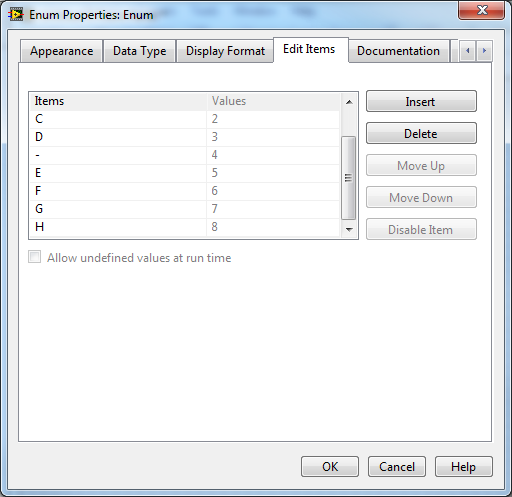

It's not a bug; a hyphen in an enum provides a list separator element in the control:
From the help: http://zone.ni.com/reference/en-XX/help/371361J-01/lvhowto/adding_items_to_enumerated/

By the way, when we use a "-", so it will result in a line devider, it takes a number, yes?
So for example we have these items:
"A" (0), "B" (1), "-" (2), "C" (3)
In this case, the devider picks number 2, which is not really good when we programm: if we want to iterate the items (A,B,C), we have to pick numbers: 0, 1, 3. It makes for loops, etc. more complicated.
So why the devider "takes" away a number? It is not really usefull....

This is indeed one problem of several with the use of separators in such controls, but:
- If you must have multiple separators in a control, use a Text Ring. Head to Edit Items for the control, then untick Sequential values. You can reorder the items but keep their values in the order you want. For instance, you could have:
A 0
B 1
C 2
D 3
- 10
E 4
F 5
G 6
- 11
H 7
I 8
etc, and you'll end up with a drop down with multiple selectors. It's a little unwieldy though.
- If you want to iterate through a text ring like the one above, you could just limit the number of iterations to the last item before your separator values start, e.g. 9.
- Enums allow a lot more flexibility, as you can put things in in whatever order you wish and then select (e.g. cases in a case structure) by name, rather than by number. Much more readable, and you can deal with the separator selection with a default case (or specifically a hyphen case, in which you do nothing!). If you want to iterate through elements of the enum, create a 1D array of enum constants, selecting which entry to use at each iteration, then pass to an autoindexing for loop.
