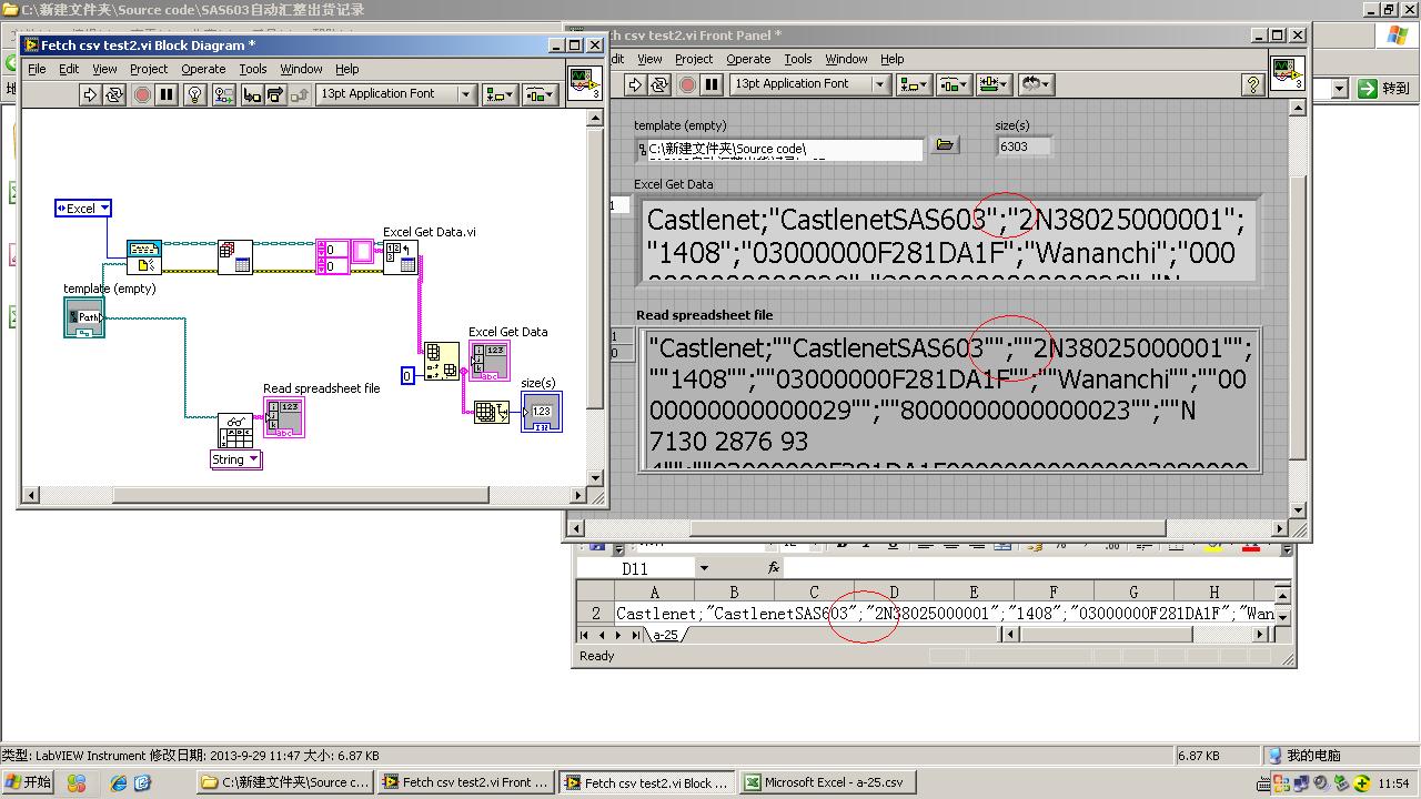

I want to get data from .csv file, but find a problem & hope someone can tell me the reason.
There are some "double quotation marks" in csv file. for example:
Castlenet;"CastlenetSAS603";"2N38024000001";"
I read the csv file with "read speadsheet file" function  but get an abnormal result as below:
"Castlenet;""CastlenetSAS603"";""2N38024000001"";""
It seems that every "double quotation marks" appear twice time
But another function " excel get data"  indicates the right data as below
I try them on different OS (XP or Win7) and different labview version(8.5,8.6); but get the same result
read speadsheet file can't indicates the right data, does anyone can help on this?

You would have to do a search and replace to eliminate the quote marks. I believe the quotes in a csv file are allowed in a proposed standard but the LabVIEW implementation does not fully comply with the proposal.
There is an idea exchange post on this that I can't find right now.
