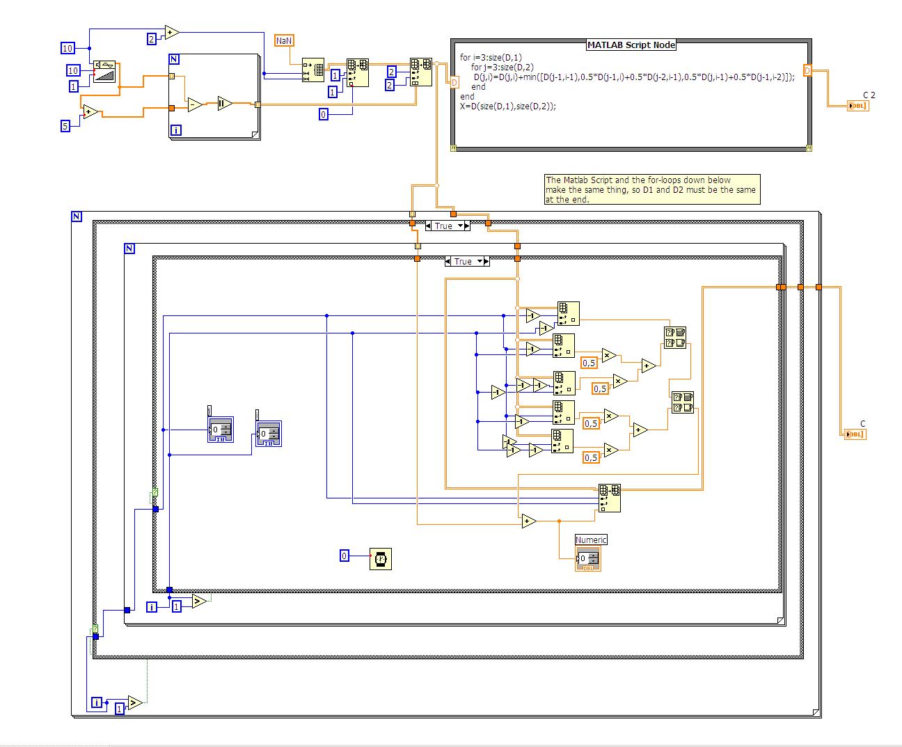

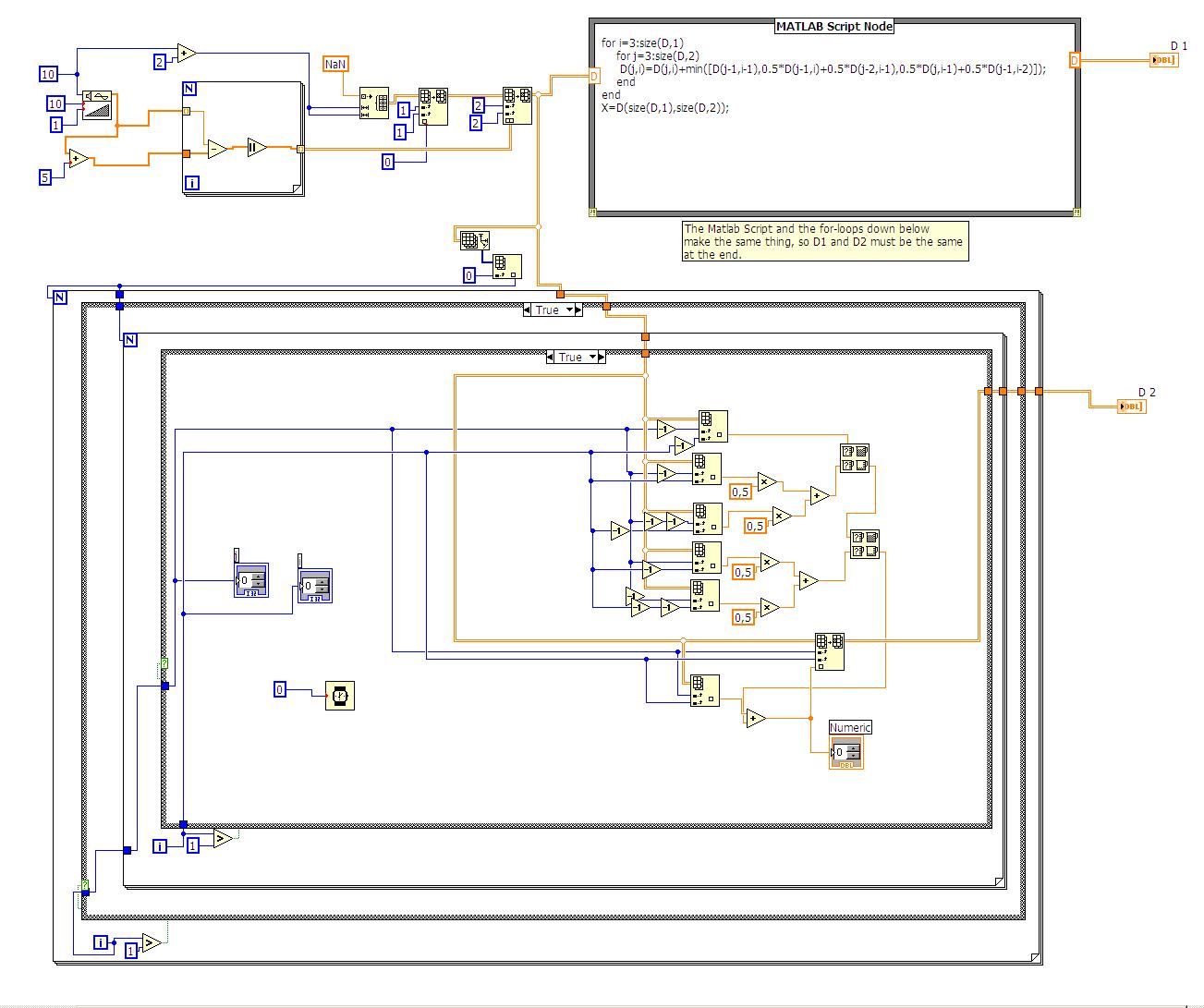

I have a VI, where i "manipulate" an array in two for-loop...
It calculate the array element well, but it didn't "save" it... can somebody tell me, how can i solve it?
(i attach two different bad solution...)

I dont have lv 8.2. Can you post a screen shot?

Solution1:forum.JPGű

The results (name:Numeric) are good, just it didn't save them... 😞

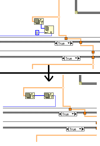

Hello!
Fix:

Wiring is a bit "tough". I dont see any point in using a time delay of "0" ms. Use a shift register to save your values.

a-a i think, you wrong...
the first array size here: 10,10 The size of it is 2... but i need to make it 10 time..

The time delay is good, if i wan't to check, if the "part results" are correct...
I never used shift register...I try it...
