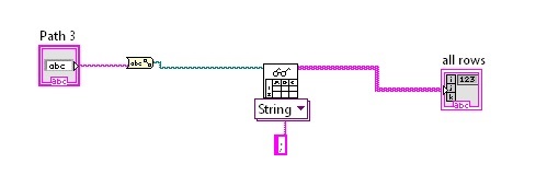

Hi Davide,
do you think you can make your way starting from this snippet?
It's rather unusual to have a different delimiter to denote EOL. You should use a comma only between numbers and get rid of the semicolon at EOL!
(4,698 Views)

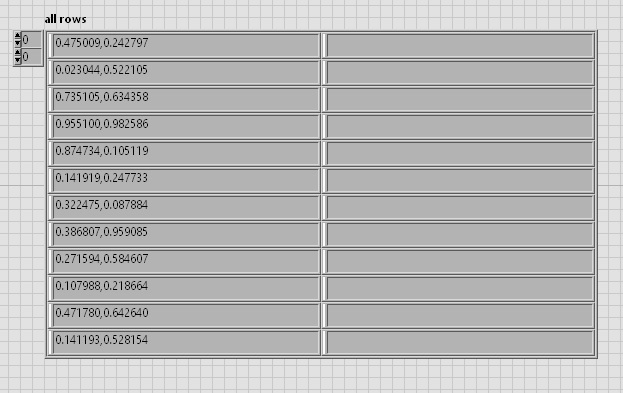

My start point is:
where all rows are like this:
i want to separate the left numbers and the right numbers into two array
Best regards

Hi Davide,
1. You need to give the separator char between your numbers, not the EOL char: change your string constant from semicolon to comma!
2. From your description I still think the semicolon is useless as you (probably) have some real EOL chars in your text file (CR, LF, or combination of both)!
(4,685 Views)
3. And you should change the type of the "Read from Spreadsheet File"- VI to Dbl, then it should ignore the semicolon and gives back the datatype you need.
Greets, Dave
(4,673 Views)
