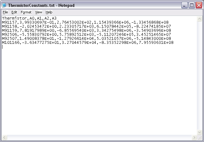

hi,
i have this .csv file
it reads something like this
Thermistor A0 A1 A2 A3
M91157 3.99E-01 2.76E+02 1.15E+06 1.33E+08
M91158 -2.02E+00 2.23E+03 6.15E+05 82247419
M91159 7.82E+00 -6.86E+03 3.34E+06 -3.55E+08
M92506 -5.56E+00 5.76E+03 -5.11E+05 3.45E+07
M92507 1.49E+01 -1.28E+04 5.04E+06 -5.15E+08
M101166 -3.63E+01 3.27E+04 -8.35E+06 7.96E+08
the only problem is..if someone ever open this file and save it..the formatting of the numbers changed. i dont know why.
so instead of allowing excel to open the csv file and might change the format of the file, i rather convert this file to text, therefore it will never ever change.

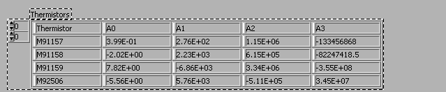

here is the current block diagram of reading this file.

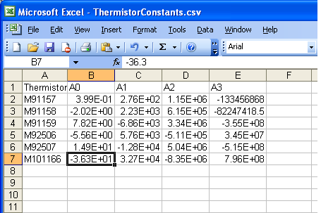

like right now..i jsut open it and everything changed.

i need to read from the text file.
to labview

Can't you just rename it to *.txt and read it the same way you always do?
Bill
CLD
(Mid-Level minion.)
(5,022 Views)
OH WOW..its that simple..i swear I have done that before and it didnt work for me. but it works now! the solution is easier than I thought...
Actually I want a reason why the formatting change from .csv file?
does anyone have a clue on why this happens?
why is it when i set the cell FORMAT to text..
then when i open and close the CSV file..it changes..
I kinda wanna know why it does that so that I can write in my document on why I am moving .csv file to .txt file

I think it has to do with the number is correctly interpreted in Excel as scientific notation and the default for that format is two deccimal places.
[Edit] Seems like it would be somewhat difficult for someone to "accidentally" do this because Excel makes you jump trough hoops to save it in CSV file.  The default save format is xls(x).
