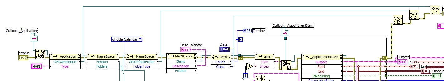

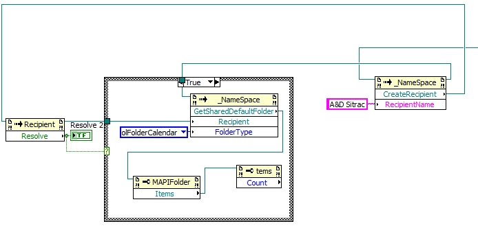

How can I access another appointment folder in red (1)? Or how is it possible to read all calender folders under "meine Kalender" (my calendar)? With the code below (2) I get access to my calendar only. I tried it with (3), to get the ref of the recipient, resolve it and getsharedfolder how is it writen here, but i cant read the count.

Here is a simple example with LabVIEW 2012 SP1 and activex. This reads only the "Kalender" (blue). How do I access the calendars "A&D Sitrac" (green) and "Test2" (red)?readOutlookCalendar7.JPG
ReadCalendarSimple Front Panel: readOutlookCalendar8.JPG
(4,169 Views)
Here is a solution to read out all calendar under "my calendar".
(4,137 Views)
