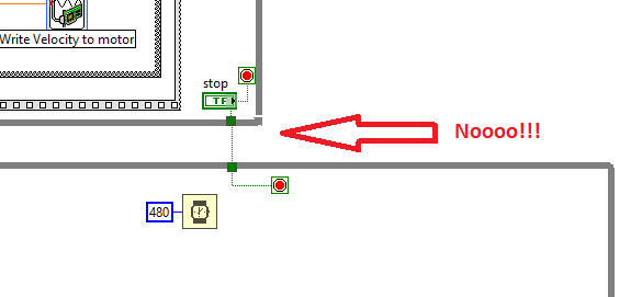

You need to start with a few tutorial about dataflow. Your stop button in one loop wired to the termination condition of another loops will generate a data dependency such that the second loop cannot start until the first loop has completed. At this point the boolean is true and the second loop will stop after one iteration.
You need to decouple the two loops so they can run in parallel.
To take a 30 second average, use "mean ptbypt" with a history size depending on the data rate to get 30 seconds worth.
