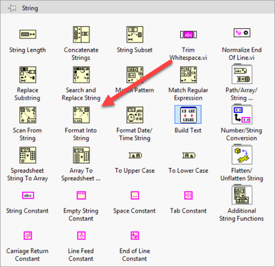

re you talking about the "Format Into String" function?  It can be found on the String Palette --
You drag whatever you want to format into a string into the bottom input, dragging down the bottom edge of the function if you need additional inputs.  The Function will recognized whether you are inputting a number, a string, or whatever.  You can then right-click it and choose "Edit Format String" (the series of characters coming in on the top".  I chose to display Year as a Decimal, Month and Day as 2-digit decimals with leading 0, and the Filename as a String.  To insert the backslash, I just put in a backslash, but since this is a "special character", I needed to "escape" it with another backslash.  You can read more about this function by right-clicking it and choosing Help.
Bob Schor
