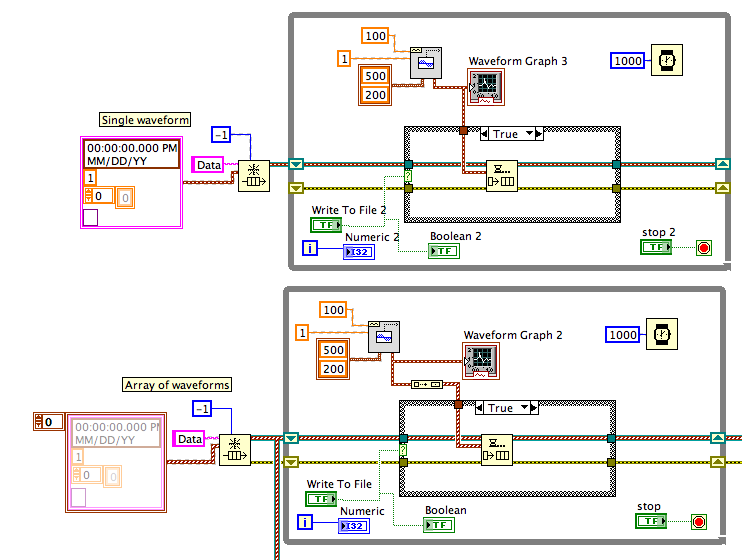

Thank you for pointing out my mistakes, I have read quite a bit about data flow programming and Producer & Consumer queues. I have had trouble in passing the waveform data to the Enqueue VI. The data that its specified for the Obtain Queue is the same as in this example (https://decibel.ni.com/content/docs/DOC-2431). But since my generated signal is not encapsulated into an array and its a standalone Waveform(DBL) type, the Enqueue Element won't accept my data. On the other hand if I convert the specified data to Waveform DBL, the file created contains no data whatsoever.
See the attached VI
Thanks again

Hint: While programming, always keep the Context Help window open. When you have a problem like the broken wire in the Producer Loop, hover over the wire with the wiring tool, and the context help window will display a description of the error. In your case it says: "Broken Wire ... You have connected two terminals of different types. The type of the source is Waveform(DBL). The type of the sink is 1D array of Waveform(DBL)."
The solution is to make both datatypes the same.  If you will be using multiple channels for your real data, than an array of waveforms (one waveform per channel) may be appropriate. If you are just using one channel as in your test VI, just use the Waveform datatype. The image below shows both methods.
Also you do not need the Wait(ms) in the Consumer loop.  The Dequeue function will wait until it has data and then execute.
