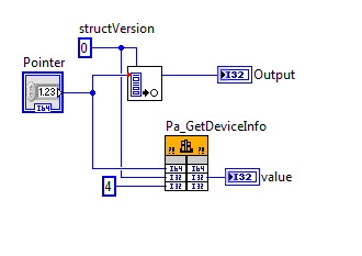

thanks a lot for your suggestion. I tried getvaluebypointer and it seems to be working fine for most of the cases. It works without any issue if I am trying to dereference integers or strings. However, if  I try to dereference a double value, then it messes it up and doesn't output the correct value. Have you ever tried dereferencing a double value using getvaluebypointer? I am using a double precision numeric to dereference a C double datatype.
Another funny thing I found is that moveblock and getvaluebypointer don't return the same value if I try to deference any data type.
eg.
they both output different values and getvaluebypointer returns the correct value.

Well MoveBlock() works perfectly if configured right. Do you use LabVIEW 64 bit? If not your first parameter is fatally wrong for sure. You should make it a pointer sized integer passed as value, then it will be right for both 32 bit LabVIEW as well as 64 bit LabVIEW. The second parameter must be a 32 bit integer passed as POINTER!

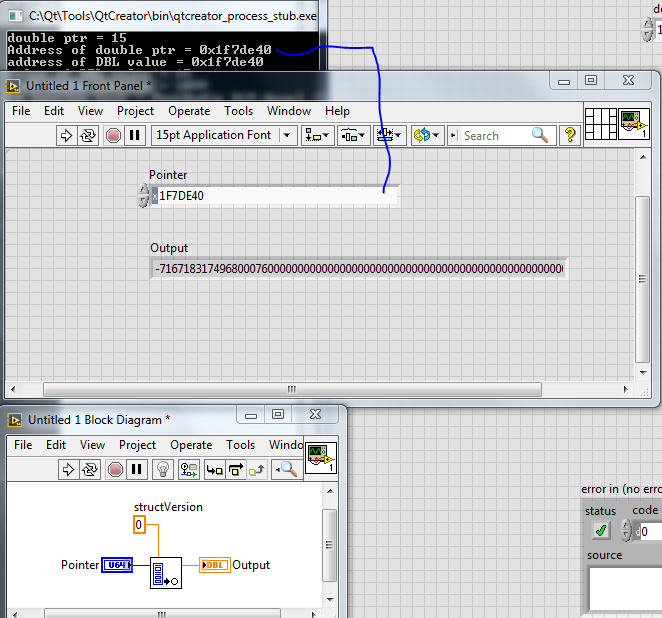

As I addressed in my previous post that I am not able to dereference a double value using GetValueByPointer. Here is the example.
I wrote a C code to initialize a double variable with a value 15 and cout its memory address.
I input the same memory address to GetValueByPointer but do not get the correct double value.
Am I doing anything wrong here?

Yes. You are assuming that all processes share the same address space. If it were that easy for one process to read (and, by extension, trample on) the memory of another process, we'd have even worse software problems than we have now.

And wait a moment! Are you really expecting an executable that uses some pointer with some value in there, to give you the same result as when you use the pointer value in LabVIEW?????????????????
That's not how every possible modern OS works nowadays. Every modern OS has virtual memory protection. This means that each process has its own virtual memory and no other process can peek into that memory. There is no way around that other than some dirty low level hacks that are to complex to explain to someone or proper interprocess communication such as network, file IO or shared memory access. Each of them requires both sides to explicitedly be programmed to allow that.
And before you ask. Writing a DLL and calling it from both processes won't directly help either unless you use proper interprocess communication. The DLL executablee code is loaded once and mapped as read only section into both processes, but any variables in the DLL will be allocated for each process individually and can't be shared in such a way either.
