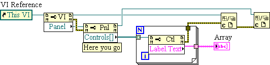

Yes use a property node to get ref to the FP (fron panel) then use that ref for another prop node to get an array of refs to all controls on the FP. Each control has a name property that use can use to decide which is which.
Use "to more specific" if you need to get at the object specific properties.

Create a property node for the VI reference and select 'Front Panel', right-click and create a property node for the Panel Class and select 'Controls[]'

Steve Block wrote:
"Create a property node for the VI reference and select 'Front Panel', right-click and create a property node for the Panel Class and select 'Controls[]' "
What is the best way to access the specific control that I want by name?
THis Nugget has a lot of hints for working with control refs.
here is a preview
Use the label to choose which ref you need.
Ben

As Ben noted, you can pull the name from the ctrl reference.  With the array of names, you can search for the one you are interested in to find its index in the Controls[] array.
