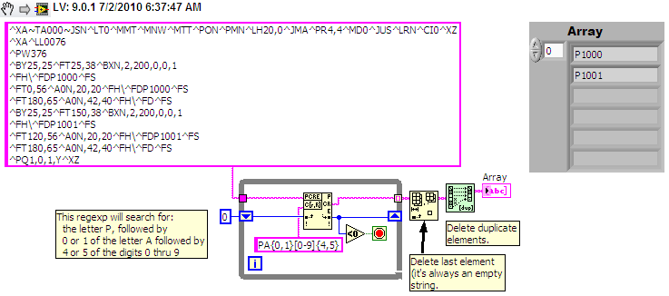

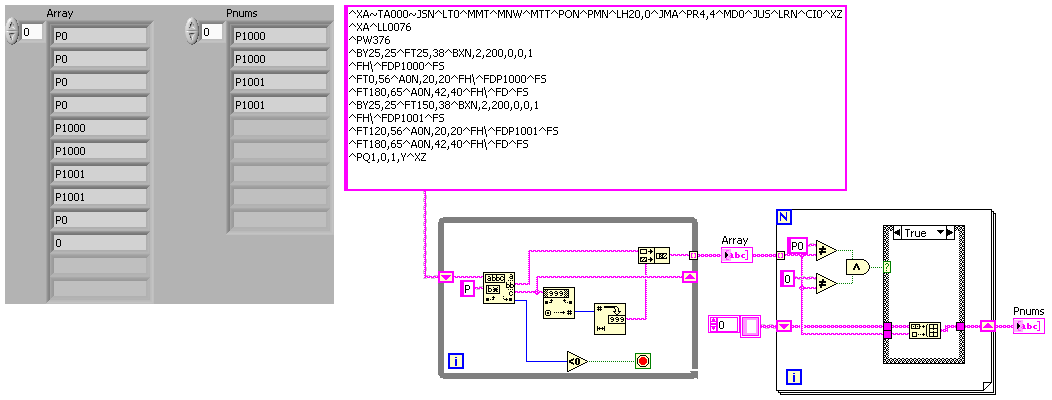

This vi extracts all P followed by numerical characters.  You have to modify it to include PA.
17993iE5847D04BBA462D2

I learned a lot from this site.
Jim
Message 5 of 8
(5,913 Views)

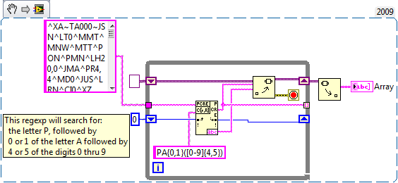

I was on travel so I couldn't reply earlier, but I was glad to see Jim defend the honor of the regex.  Call me old-fashioned, but I do not have OpenG installed on all of the machines I come across.  Instead of deleting the duplicates, what I do instead is to use the attribute of a dummy variant to hold the values.  Duplicates are nicely handled and the final iteration errors out when you try to write an empty name.  I do not use it here, but I made the number itself a capture group, so the value of each attribute is the number itself.
18075iCAB38B4EC0C68457
