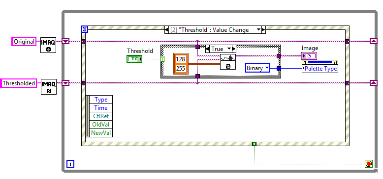

The IMAQ Images transfreed by references, not by values. After thresholding you have no original image.
Use design pattern like this:
See attached VI too.

Hello..
Thank You very much, this is the best solution...
But...i want know how can i put a slide for change the range of the threshold?
and how can i do that ..automaticaly.....whan i change the value of the range automatically change in the image.?

Hi
Place a slide to control either the min or max value of your threshold range and use the slider value change event in your event structure: like this
Hope this helps
