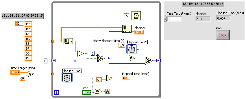

it is hard to make any sense about what you are saying? according to your block diagram...you are getting your array value and converting it to a U32 then convertin again to a string, then again to a dbl and a I32...very confusing.
you can do this with a simple while loop, shift regs. and timer...i try and stay away from flat sequence programming as you cannot transition as well as a state machine architecture.
(3,020 Views)
try not to use the wait(ms) function for your programming timer (CLD requirement). Elapsed Time Vi can be your friend...

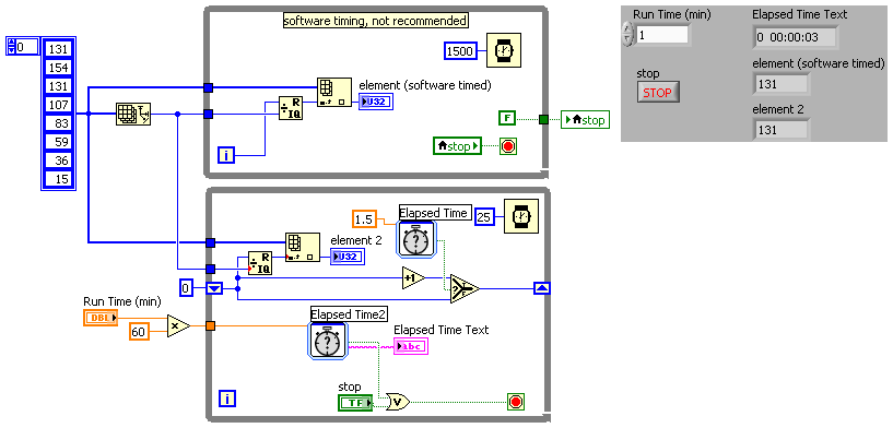

the problem is that the "for loop" will run dependent on the Ncount or array size, which ever is smaller. Use of a "while loop" is repeatable...
a different take using Quotient & Remainder...
