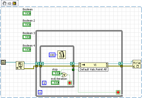

Be Careful-  If any of your booleans has a latching mechanical action you will get an error trying to write the Value property.
Here is a way around your problem that uses the re-initialize all method.  Boolean 4 and both loop terminators are latching booleans the rest are switchers.
1 word of caution-  Because I used the "this vi's path" constant you have to save the vi first (so it has a path)

Jeff,
Is there any reason for your outer for loop?  it's going to stop when the inner for loop stops because of the stop bool, or not at all.  Why not just have the invoke node outside the small loop?  Or am I missing something?

the inner loop is there to provide a controlled delay (so the buttons can be pressed by the user) simulating a test process is occuring.  When either Exit itteration or Stop is pressed the test loop ends and the reset process takes its action (runs Method>Reinit all to default)the outer loop allows the code to be run again and again until stop is pressed.

Oh okay.  I was thinking it was just an example to show off the invoke node.  It's a bit more complex than that.  I got ya now.

Additionally, I you really nuke it out, the value of the stop button MUST be known when the inner loop exits.
There is  no other data flow controlling the order of "Set Stop False" (inside the method) and read value of "Stop".  In fact I wound up pressing CLT. while I worked up the example (I originally left "Stop" outside the inner loop).  Race condition AND infinite loop.  Smiley Mad
Just shows that you need to be careful when playing in the deep end of LabVIEW ( multiple accessors to set a value)
