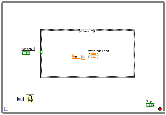

This is simple question but I can't seem to figure it out. The attached VI shows random numbers vs time, and I'd like the x-axis to reset back to 00:00:00 everytime I turn on the boolean. I've gone through the chart properties but I can't find the option that allows me to do that. Can anybody help me?
(2,915 Views)
You need to wire an empty array to the property node for history in the false case.
Make sure you create stop button to stop your VI rather than using the abort button in LV.  It is a good habit to get into.Smiley Wink
