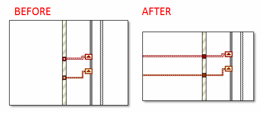

Hi meysam_b,
You need to wire through all data in every case in the event structure.
Repeat this for every wire that goes through a shift register.

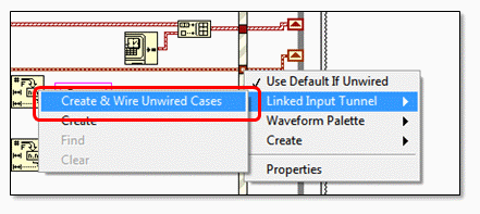

The fast way to do this is to link the tunnels. Right-click the output terminal then use the Linked Input Tunnel menu to establish a link. After you choose Create & Wire Unwired Cases just click on the associated input tunel and LabVIEW will create the links for you automatically.
This should fix the resetting time stamp.
