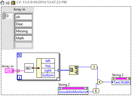

There is a function called Get Text Rectangle that will give you the size of the text in pixels.  The advantage is that it also accounts for the different widths of different characters in the font.

Just a minor tweak to RF's code to account for the strangeness that property Text.Width refers to the outside dimention of the surrounding decoration.
Without the add the "g" in "Missing" goes missing.   While this looks like "Just a touch" of overkill select "Visible Items" Display style after running the vi as is Smiley Wink

Very weird.  Your strings do need that.  (Actually makes it a bit wider than it should need to.)
When I did it originally, nothing seemed to be cut off.  (Mostly it was various length strings of numbers and "asdf".)  It always seemed to show the whole text.
(5,438 Views)
Playing a bit more you should probaly subtract Left from Right in case the text is right justified.  trivial
