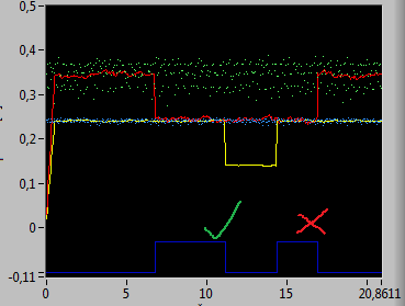

I have a similar problem.
I have two voltage meters that output a "high" and a "low" signal.
I want to measure the duration of a drop when the first signal is low and the second is high, but only when the signal falls, not when it rises.
This is the screenshot of the current output.
As you can see it detects both cases instead of just the first.
I can also provide the VI if needed.

Well, I don't work with LV anymor as I changed my job, but let's give it a try...
Obviously, you already measure the first duration correctly. As you measure the second duration as well, there must something be wrong with your "triggers". I'd suggest you to build kind of a truth table for the trigger conditions.
For example U1 is high and U2 is high = idle, U1 is low and U2 is high = start measurement and so on. This can guide you to the current problem or it may help you create another trigger logic.

Yes, I'ver come this far, but I can't figure out how to build the truth table you mentioned.
For now it's like this:
if the signal is high, it records the time. If the signal is low, it doesn't.
