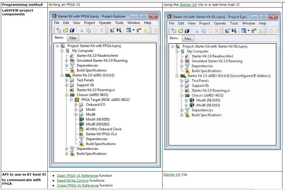

To clarify my question, I would like to work in an enviroment similar to the one on the left, instead of the one shown on the right, but for the starter kit 1.0

I don't have the starter kit 2.0, but you could add an FPGA target to your existing chassis.  You'll need to configure the chassis to be in FPGA mode rather than scan engine.

Certainly as it says "jordankuehn", what you see on the left of the image is a project, that added a FPGA Target (Right click on the chassis >> New >> FPGA Target), which allows you to work in FPGA environment and not in SCAN mode Engine (picture right). Now unfortunately the 2012 version of LabVIEW and the LabVIEW Robotics Module 2012 does NOT contain an example to customize the work with the Starter Kit 1.0, unlike an example to work with the Starter Kit 2.0.
