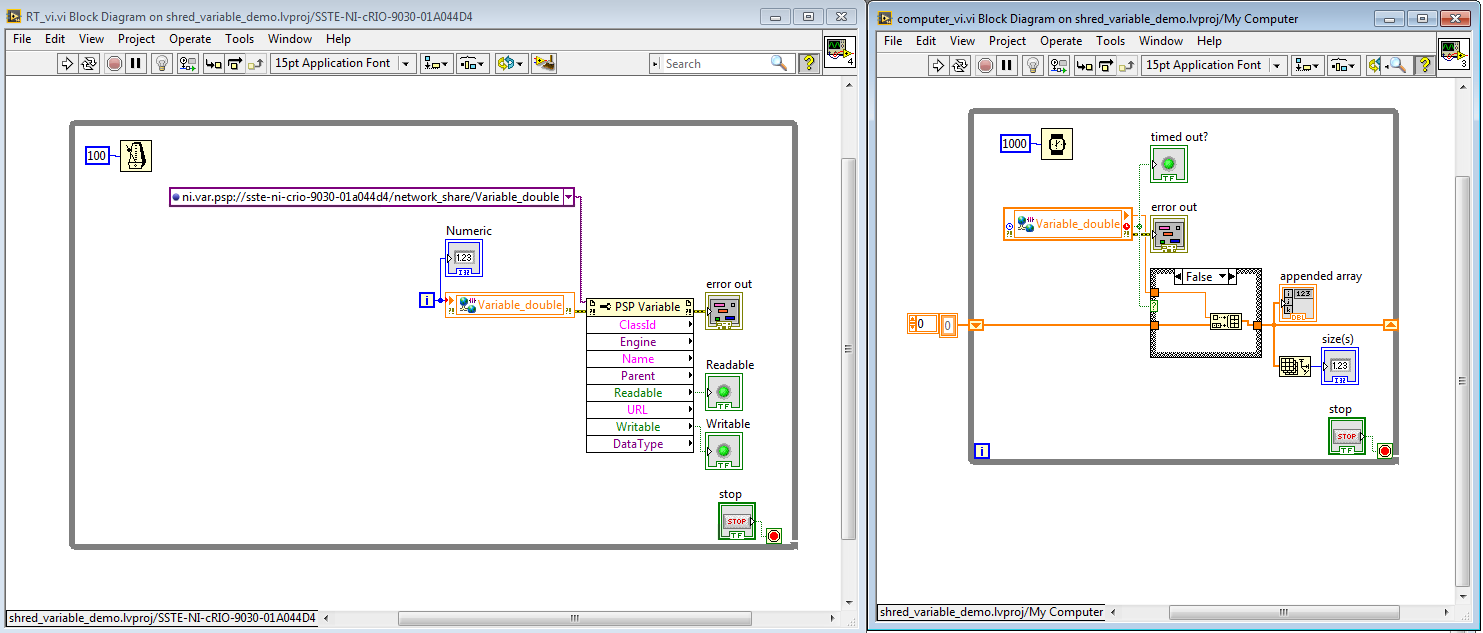

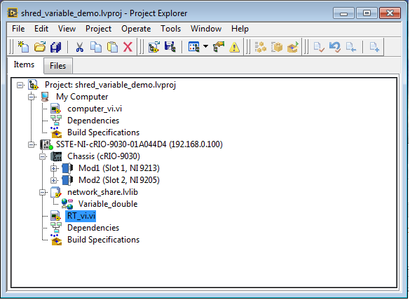

So i have a cRIO 9030, and its going to make some measurements for me, and i originally wanted to send them in to a database, but since database connectivity dose not work on RT I need to get the data though another computer.
I can“t afford to lose data, so I though make a queue on the cRIO where my data is filled in and then share one variable, that variable I then want to read from a Windows Labview and send to my database. But the cRIO needs to make sure that the data have bin sent to the Windows Labview successfully. First I thought I make a RT Fifo share and I would get a error if I fill it, but that is not the case.
I have made a small example where the cRIO makes data with a 10 timers higher rate than the Windows reads, meaning I would get an error if I try to fill it, or so I thought.
Any ideas on how to get data safe from my cRIO?

Instead of a shared variable, use a Network Stream.  It is a lossless communication using TCP.
In your RT, you will want to use a seperate loop that handles the stream and use a RT FIFO to send data to that loop to be sent out.
