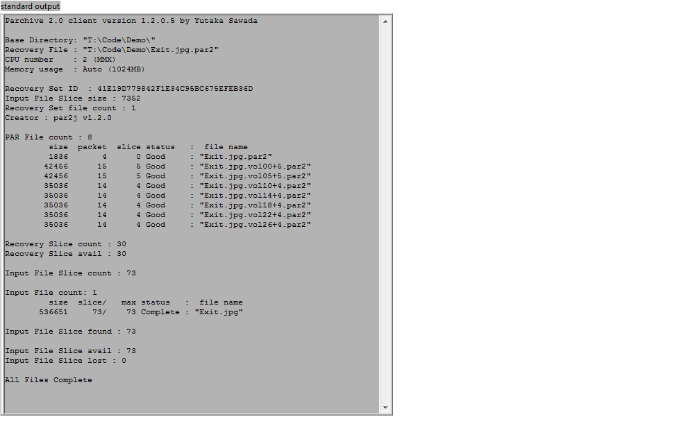

I tried the qutes and I get the reply as shown in the attached, and the message dowsn't say repair not needed, so I don't think its working. Also, the ERROR CODE should be 0 and not 1.

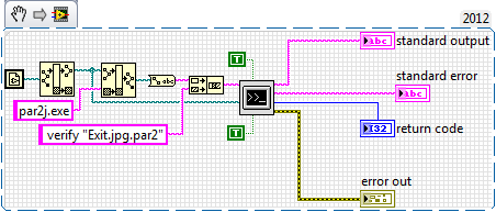

Well, I ran it again  & got the same "valid file not found" error as you. Weird. It's to do with the working directory not being set.
If you wire the directory to the "working directory" input of the System Exec function, it then works.
par2j snippet
par2j output
