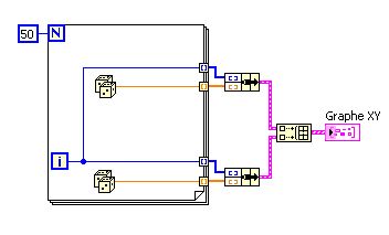

You can create a XY graph like this
If you put the same x-axis, you will have synchronous Y-axis. If you want to see the timestamp you can replace index by the vi Get date.
