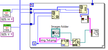

I dont have IMAQ, but I have 12bit grayscale images generated by a ThorLabs camera - what can I do?
... what I accomplished so far with this:
... is to get completely distorted images.

I think I'm getting a "Reputation" on this Forum!  Please, do not attach pictures of a part of your VI, but instead attach the VI, itself.  We need to see all of the code, in context, to be able to make the best (or sometimes the only "non-guess") suggestions.  We can't see, for example, what ThorLabs routines you used to acquire the images.
What does ThorLabs say about how to do this?  Have you run any of their example code (assuming they have such)?
Show us the code, please.

of course...
I have this habit due to long years on very different forums, where heavy attachments were frowned upon... (oh, the BBS & modem times!)
here's the code
