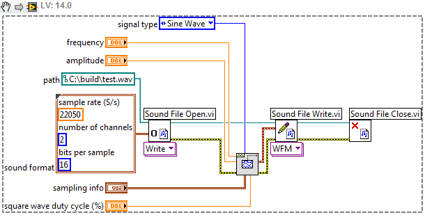

I am not sure why it is not working for you. Please post some code.
Spoiler

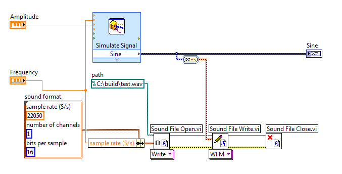

Here is my attempt at save the sine wave file as a wav file.
Message 4 of 11
(7,694 Views)
  • Create a filepath for the file that you're creating. You haven't set any path.
  • Use the Open and Close subVIs from the same palette as the Write.
  • Make sure the file type is ".wav"
Cheers
Message 5 of 11
(7,685 Views)

This isn't necessarily a warning, it's just letting you know that your data was out of range for a wav file, so it had to clip it.
Your waveform data must fit within the -1 to 1 range.
Cheers

Can you please look at the spoiler section in my first post
